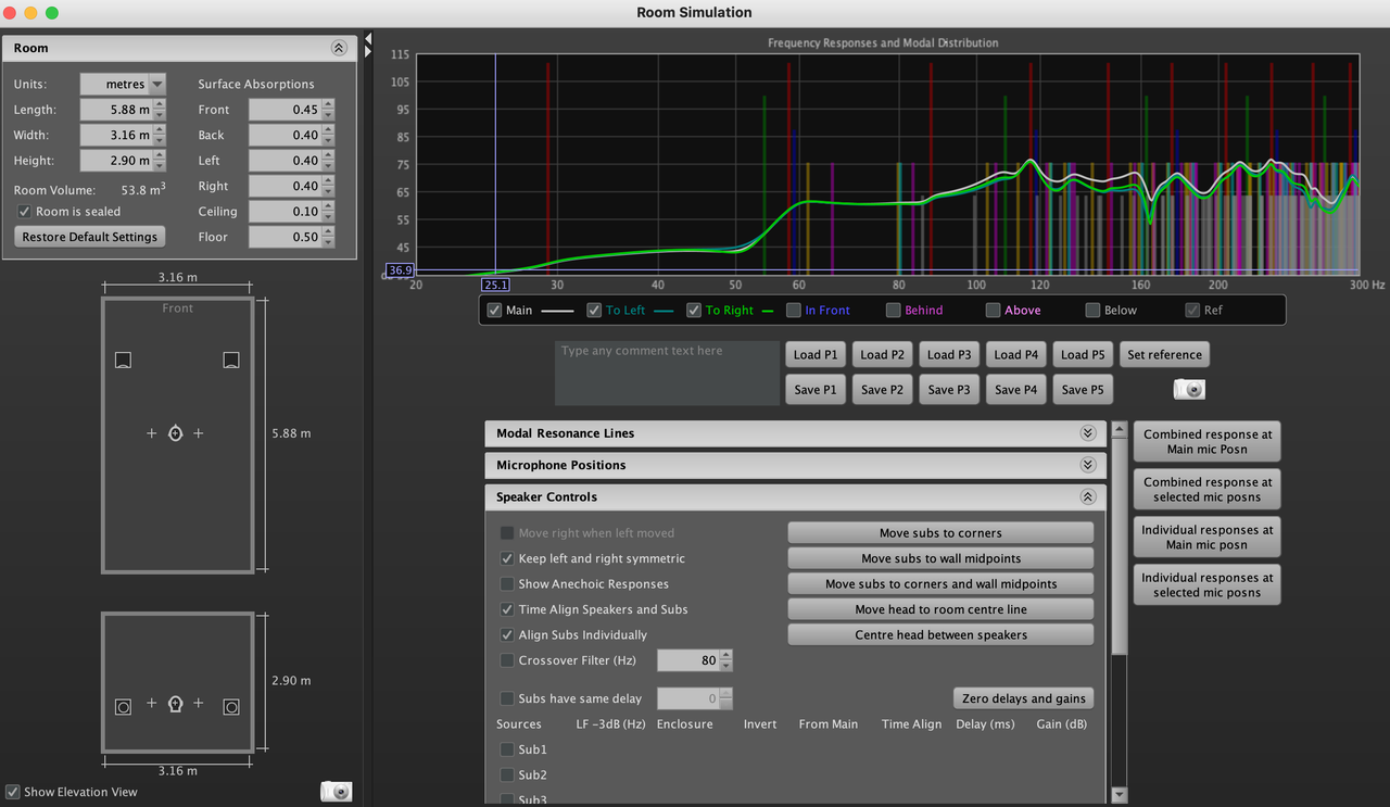

First I would go to the Room Sim and enter your room dimensions and speaker positions, and 2 mic positions one for each ear. This will result in a frequency graph which will estimate the Frequency response 20hz to 300hz, you can now play around with speaker positions and listening positions trying to get a reasonably flat response, you can drag the head and speakers and see the graph change in real time. Once you have and idea of the best speaker and listening position onto the next step below.

Below are examples of my room measurements
https://i.postimg.cc/50m97xKj/Screen...t-12-36-08.png
https://i.postimg.cc/NFfsZWZD/Screen...t-12-31-21.png
