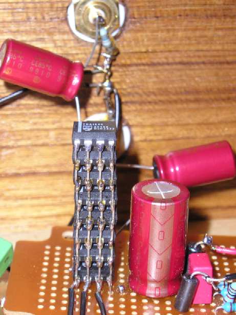

    I'm quite tempted to get 8 more TDA 1543 chips and do the 'solder together' mod as it improves sonics quite significantly apparently. I also wonder if a TDA 1543A and 1543T would improve/change things at all and if they are indeed swap in/out as a direct replacement. As they are not being used with any filter I would imagine so?
    If anyone has any experience on this any advice or recommendations it would be most welcome.

    I was wondering about the adding chips thing as I think a lot of the TDA1543 DACs I've seen have 4/8 (or even 16?) chips in them.
    The other thing I've wondered is, are these still made by Phillips or are there Chinese "replicas" being made to supply the new found demand for such old chips? As I can't believe there are NOS mountains of all the chip types sitting around waiting for someone to decide if they are good again.

    Can you explain what you mean by 'stacking some more chips' ? Do you mean literally wiring the chips in parallel, pin for pin?
    Thanks
  10. #10
    Join Date: May 2018
    Location: Woking
    Posts: 803
    I'm Chris.
    Thanks
    Yup, might take a little more care + some heatsinking than this though . . . . apparently does improve most aspects of the sound. Lowers jitter/distortion somewhat (or errors at least).
