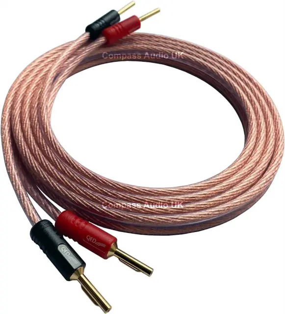

And then it dawned on me. When I set the system up originally I used my Van Damme 4.00mm tour grade speaker cables that I had in my box of Hi-Fi plethora. Really good cables, and extremely low impedance at 0.00045Ω per metre. They were a bit short so I decided to order the Van Damme 4.00mm domestic cables, which are prettier. When I thought about 'when the problem started', I realised it was after the new cables went in.
In the loft I went, found the tour grade cables, and swapped them over. Before doing any listening, I went into the DAC's ferociously deep and complex menu, and zeroed absolutely everything - flat as a pancake, as it should be.
Started playing something - and bang! Perfecto. Clean, even and crisp; like a good pizza.
Now, I don't care why two near-identical cables from the same manufacturer should be so electrically different (the tour grade is a few thick strands, the domestic a very multi-strand), but the difference is staggering.
