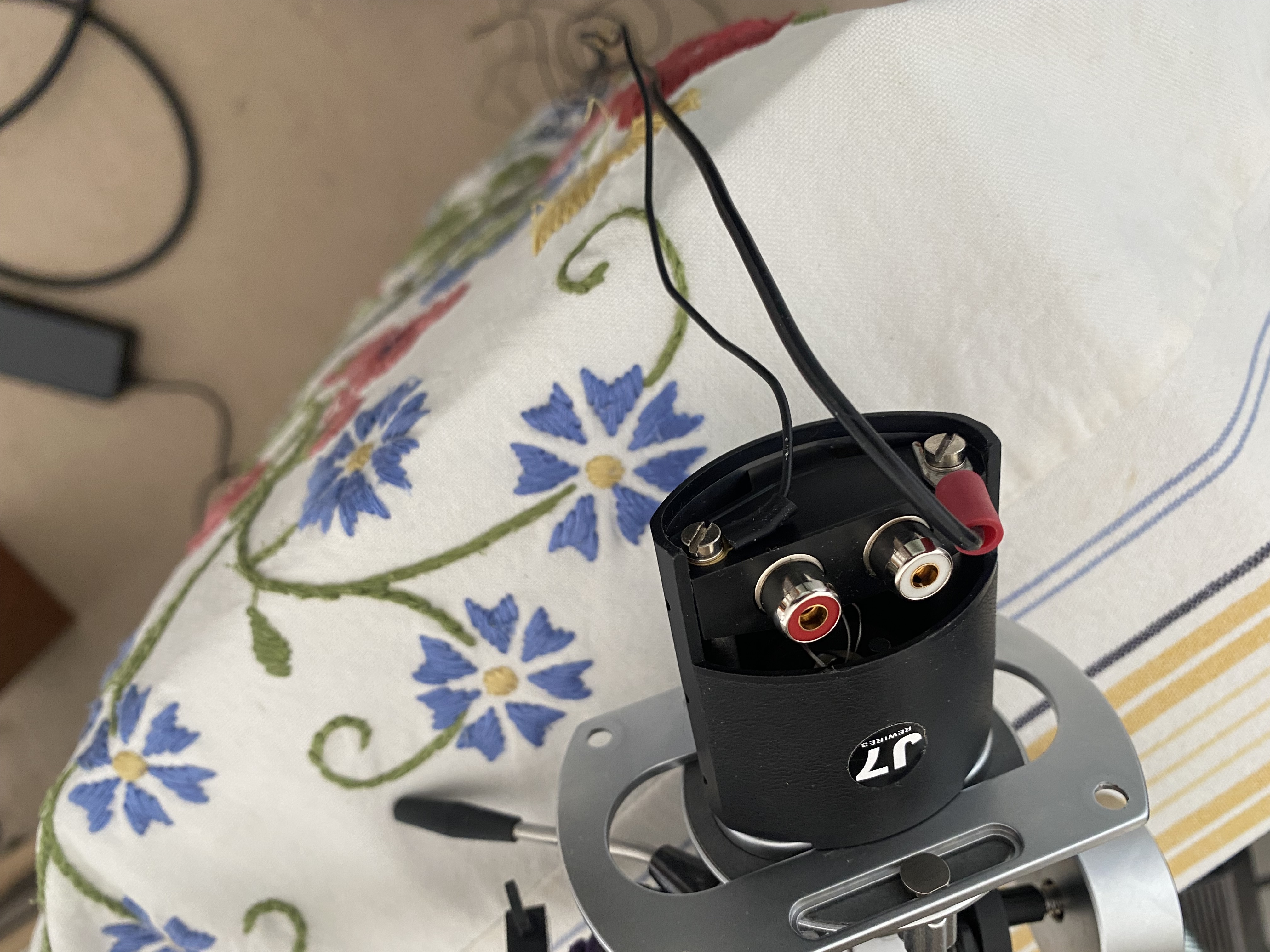

Hello old friends it's been a while. The 301 and it's infrastructure has had some more work and I'm happy to announce that it's paid off very nicely. Firstly, the new 3009 arm has been properly installed and is now working. It still needs a few very small tweaks but nothing that can't be fixed over a cup of tea. So, here's what's been done with the new arm.
SME 3009
- Audio Origami - Full check and service.
- New Michell silver cartridge tags
- Fully rewired with Zavfino silver tonearm cable
- New earth leads made to earth tonearm to 301 and the phonostage at the same time.
- New 3D printed fluid damping tray and paddle fitted.
- RCA conversion with silver plated RCA's
- Mark Grant Mark Grant Oyaide FTVS-510 pure silver cable with WBT silver RCA's.

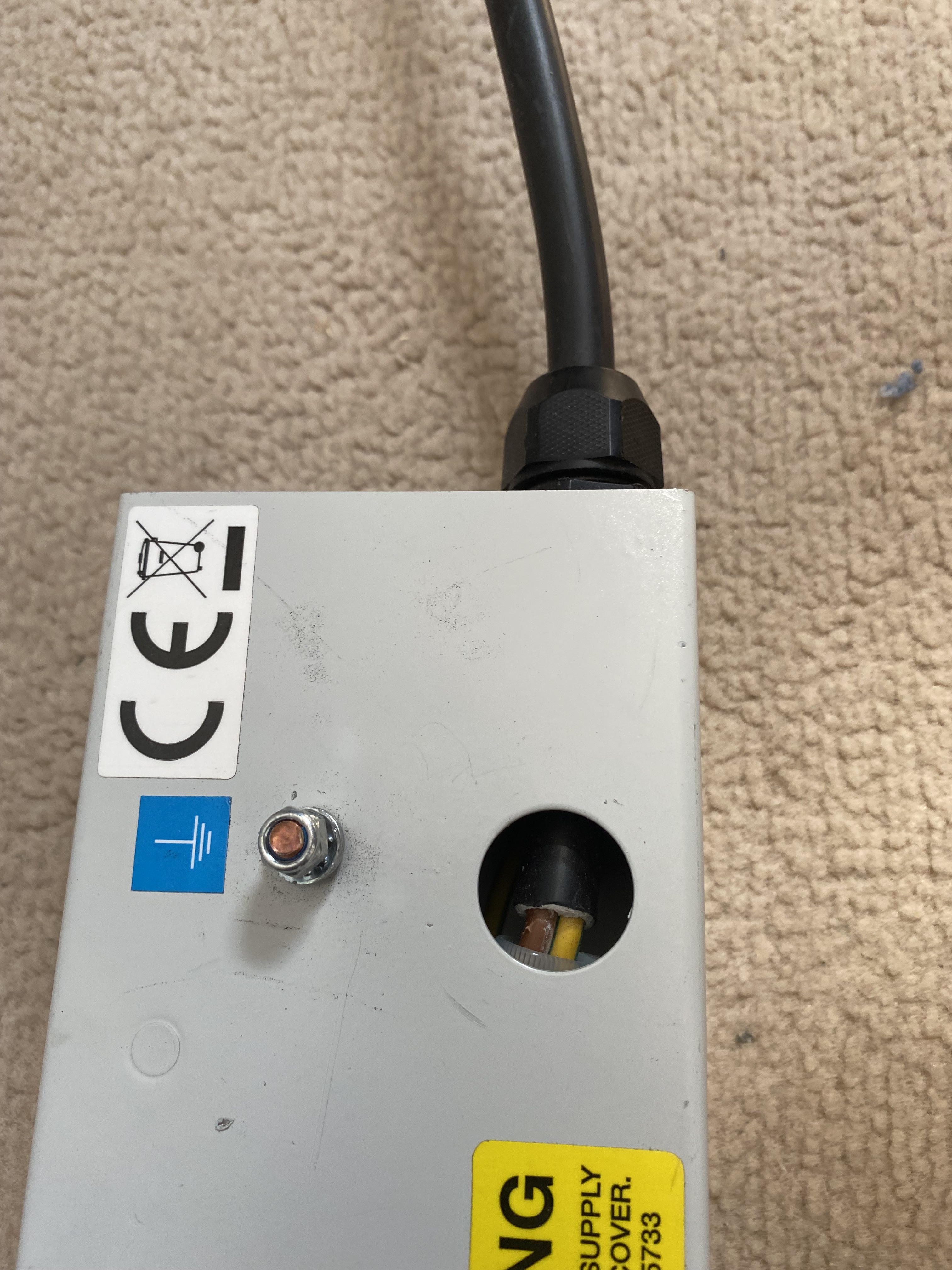

As you can see it's been extensively overhauled and treated to some nice audiophool stuff. I've grounded this tonearm to the Nth degree. Double earthing wires. These now earth the tonearm to the phonostage and also the 301.
https://i.ibb.co/gLHjgsbd/IMG-2463.jpg

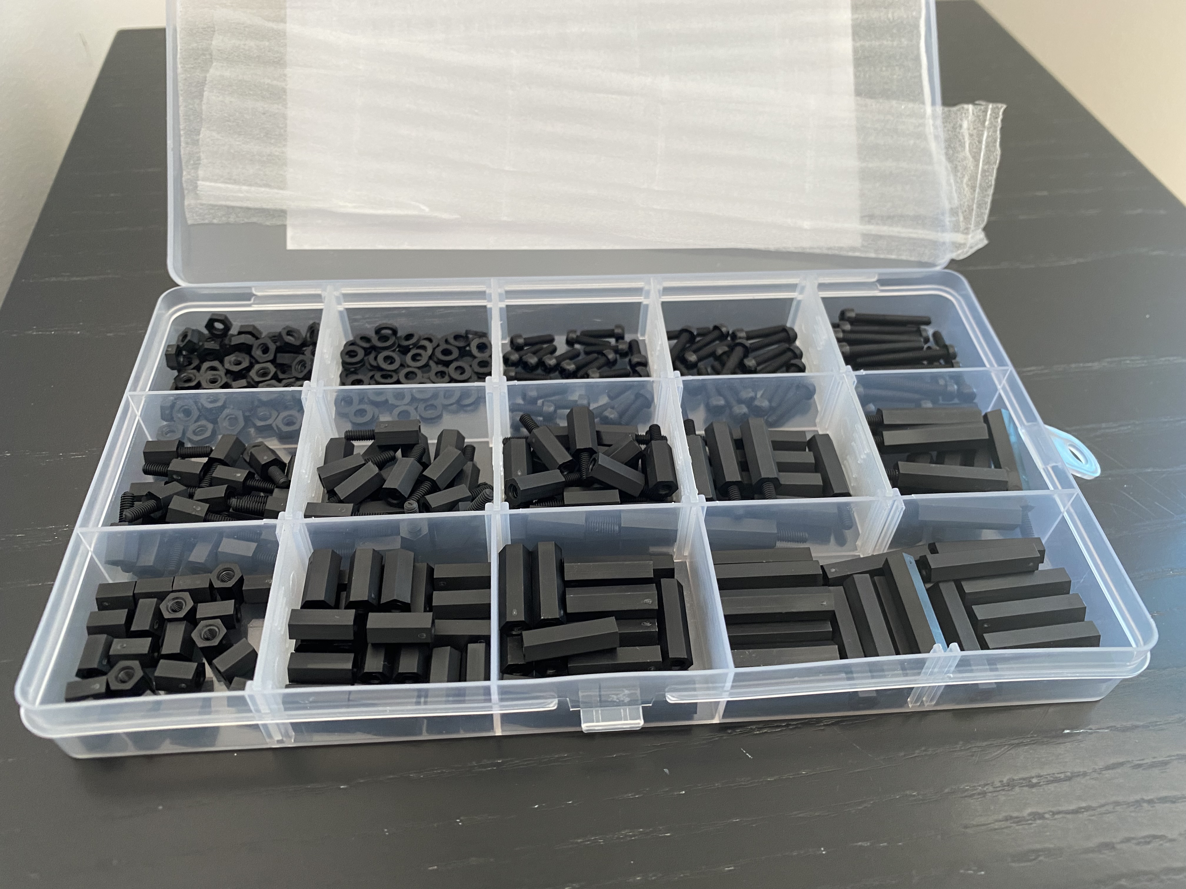

I also looked into lessening the chances of Earth hum and bought myself some plastic mounting screws and also keeps the mass of the tonearm down when I start using very low 1g tracking cartridges.
https://i.ibb.co/cS7QGwTJ/IMG-2464.jpg

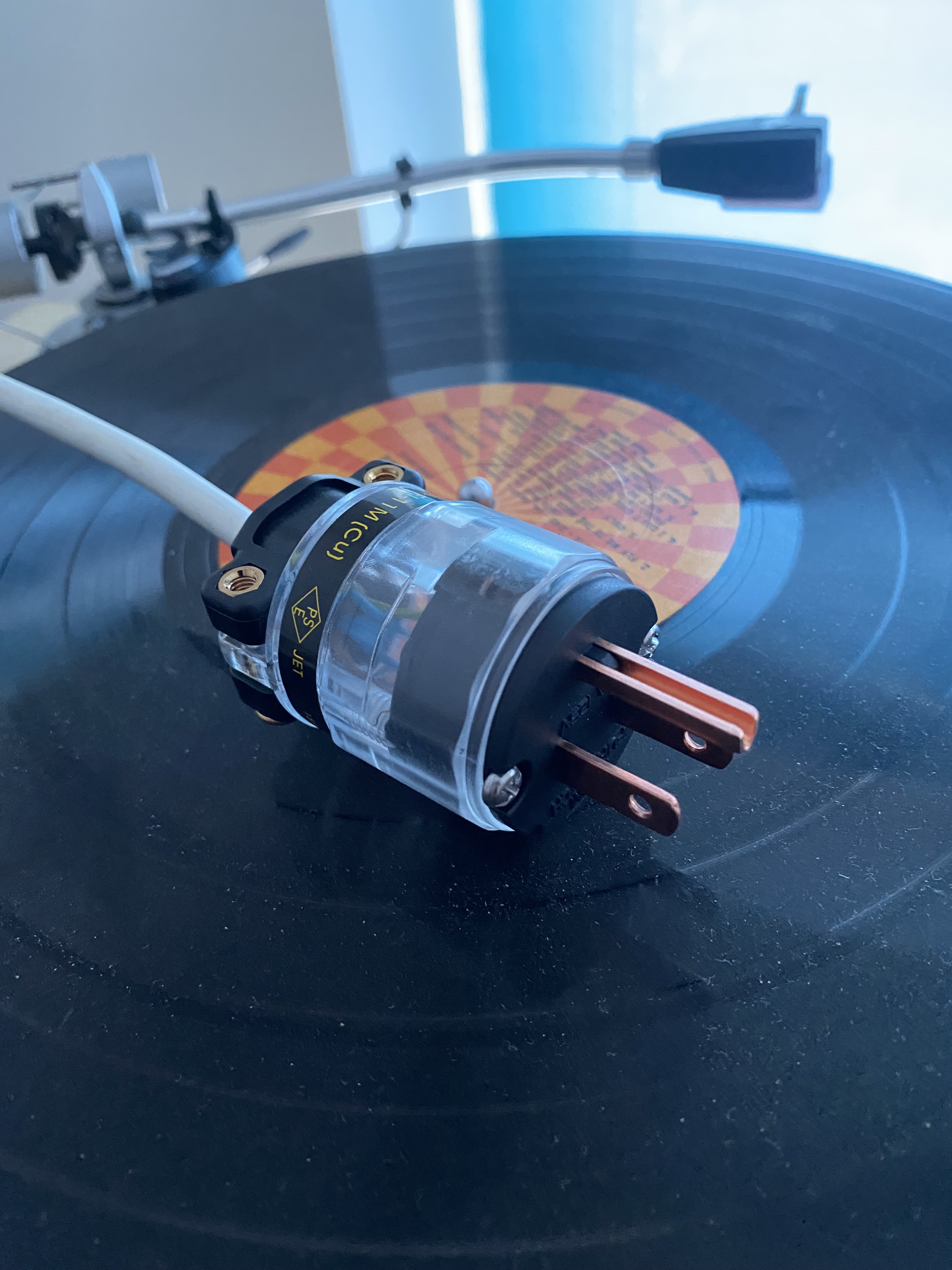

The power supply into the 301 also had a bit of a change in that I got rid of the USA to UK plug converter that I had been using for a number of years. The 301 new sports a pure copper Furutech fl-11m plug. One less component in the chain and it looks a lot nicer.
https://i.ibb.co/0VzN07Qw/IMG-2466.jpg
https://i.ibb.co/9m172jnW/IMG-2468.jpg
https://i.ibb.co/tT9St8Fx/IMG-2469.jpg

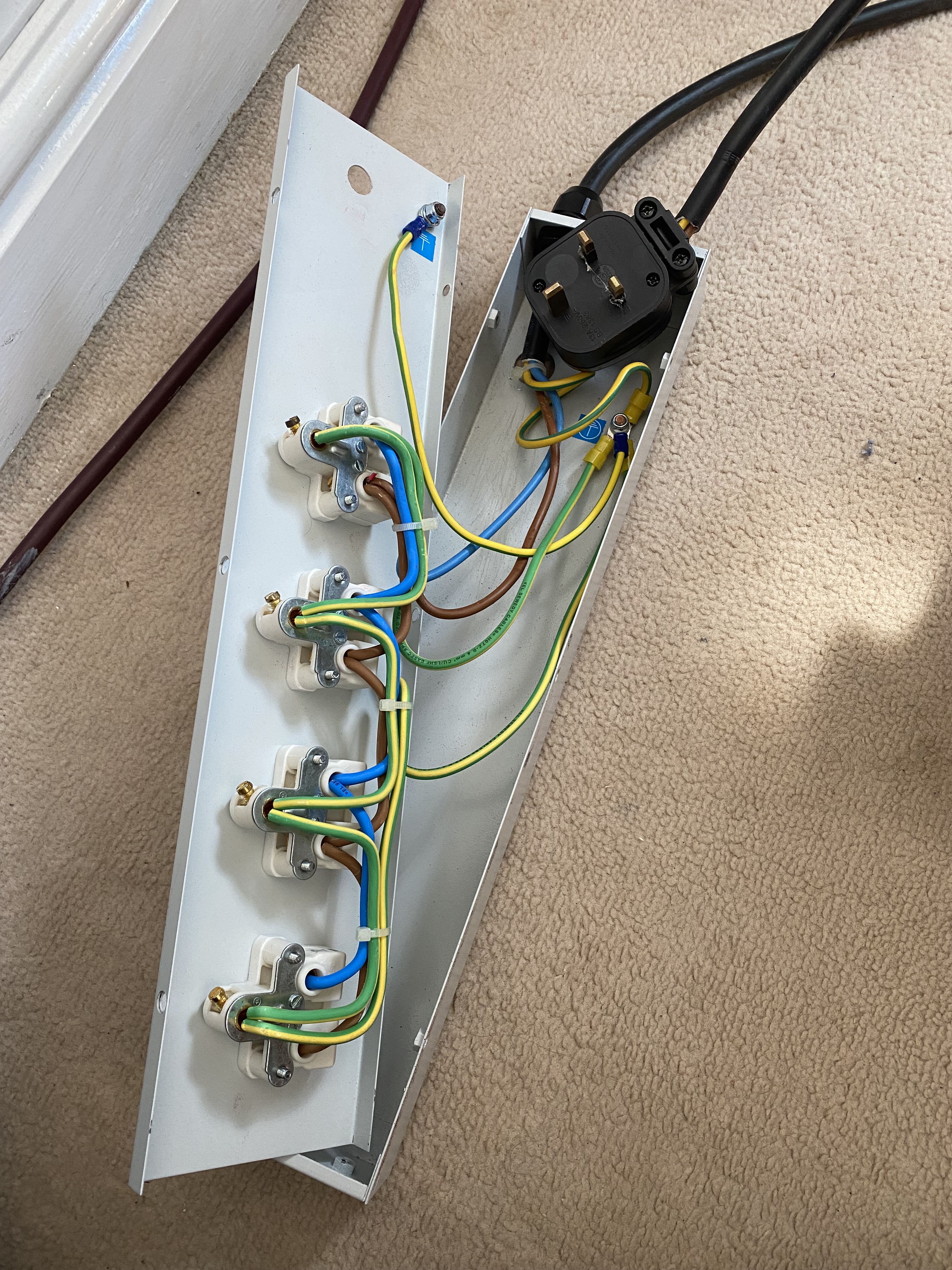

Finally I decided to go down the route of a new Olsen (well new second hand) power strip to handle the phonostages that I have connected to the 301. I did a couple of modifications to this powerstrip, firstly I removed the LED on light and I also re-routed the cabling so the powerstrip can lay flat on the ground, and I added a decent plug.
https://i.ibb.co/DgYTSp0Z/IMG-2475.jpg
https://i.ibb.co/PvgHxYcV/IMG-2476.jpg

What is the unit, shown in the second photograph, that has a US style socket on it? Is it a power supply for the 301?
Otherwise all looking good, especially the upgraded SME arm. :)
The power supply was an American Product produced by a company called Pheonix Engineering
https://positive-feedback.com/review...and-eagle-psu/
They did a 17W and a 24W (I think) version, the 17W version was good for Lenco decks but a little under rated for the 301/401's so I use the 24W version. They never produced a UK plug version so you had to buy an adapter and hence why I attached the new Furutech plug. The whole system works fine in the UK, I've been using my system now for probably 10 years without problems. I also have a spare just in case.
