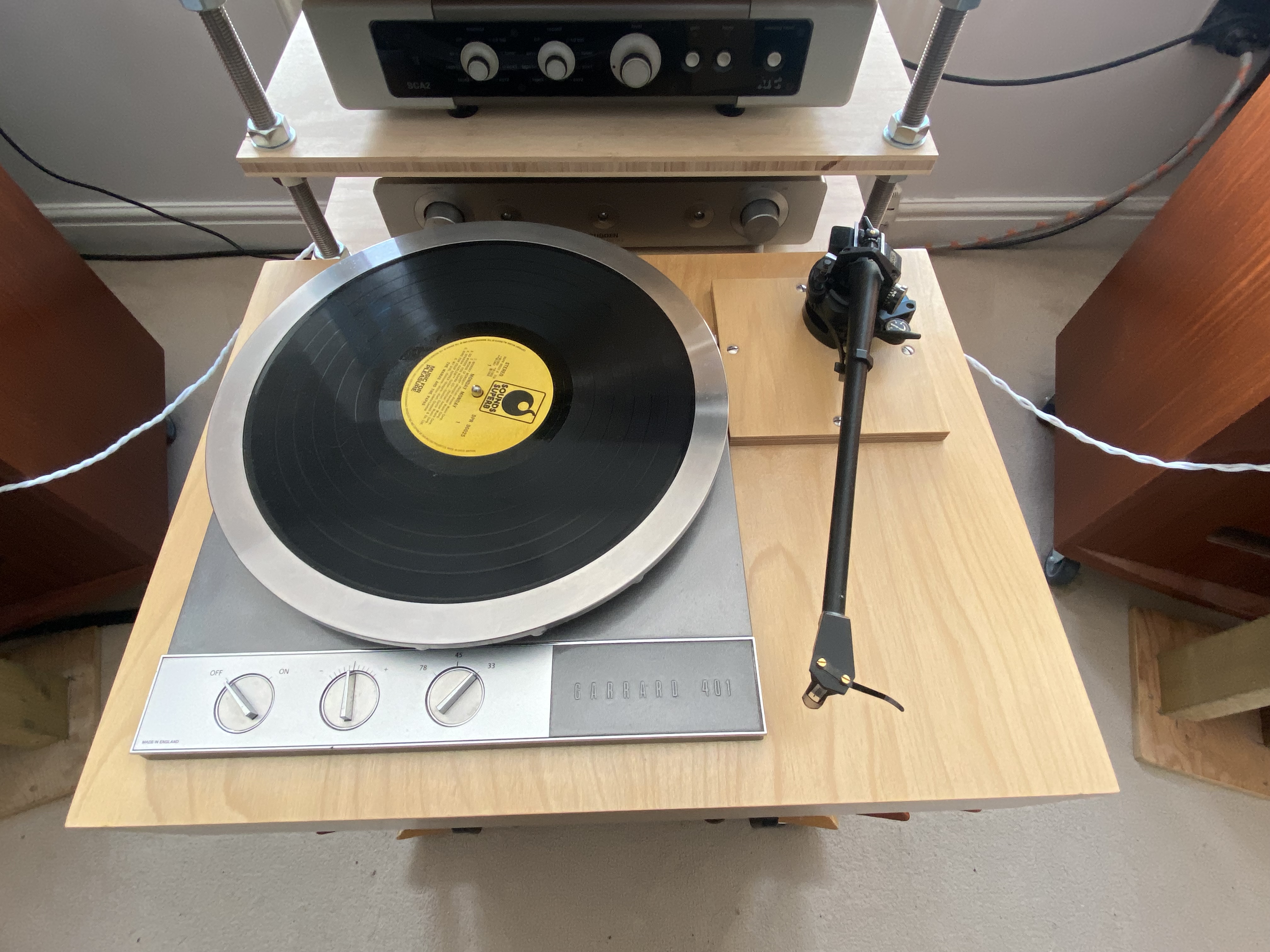

BBC DRD/5 record replay unit using the Garrard 301 turntable.
The DRD/5 was introduced to supplement the TD/7s by providing facilities for playing 33 and 45 rpm discs. The turntable was a modified Garrard 301 with the 78 speed disabled. An Acos crystal pick-up (type HGP 39/2, also used on domestic equipment) was mounted on a BBC designed arm.
These machines had an optical groove location system. The small screen on the left behind the turntable displayed a scale indicating the position of the arm.
The turntable plate rested on felt pads and the start/stop lever caused the rotating turntable to rise or fall beneath it. This used a mechanical link and gear system and the lever had to be operated gently to avoid making the stylus jump out of the groove. As the turntable rose the motor volts were boosted to increase the starting torque. Initially the machines were fitted with a muting control to prevent wowed starts, these were later disabled. Set-up was easy, of course, as the disc could be wound back without causing damage.
