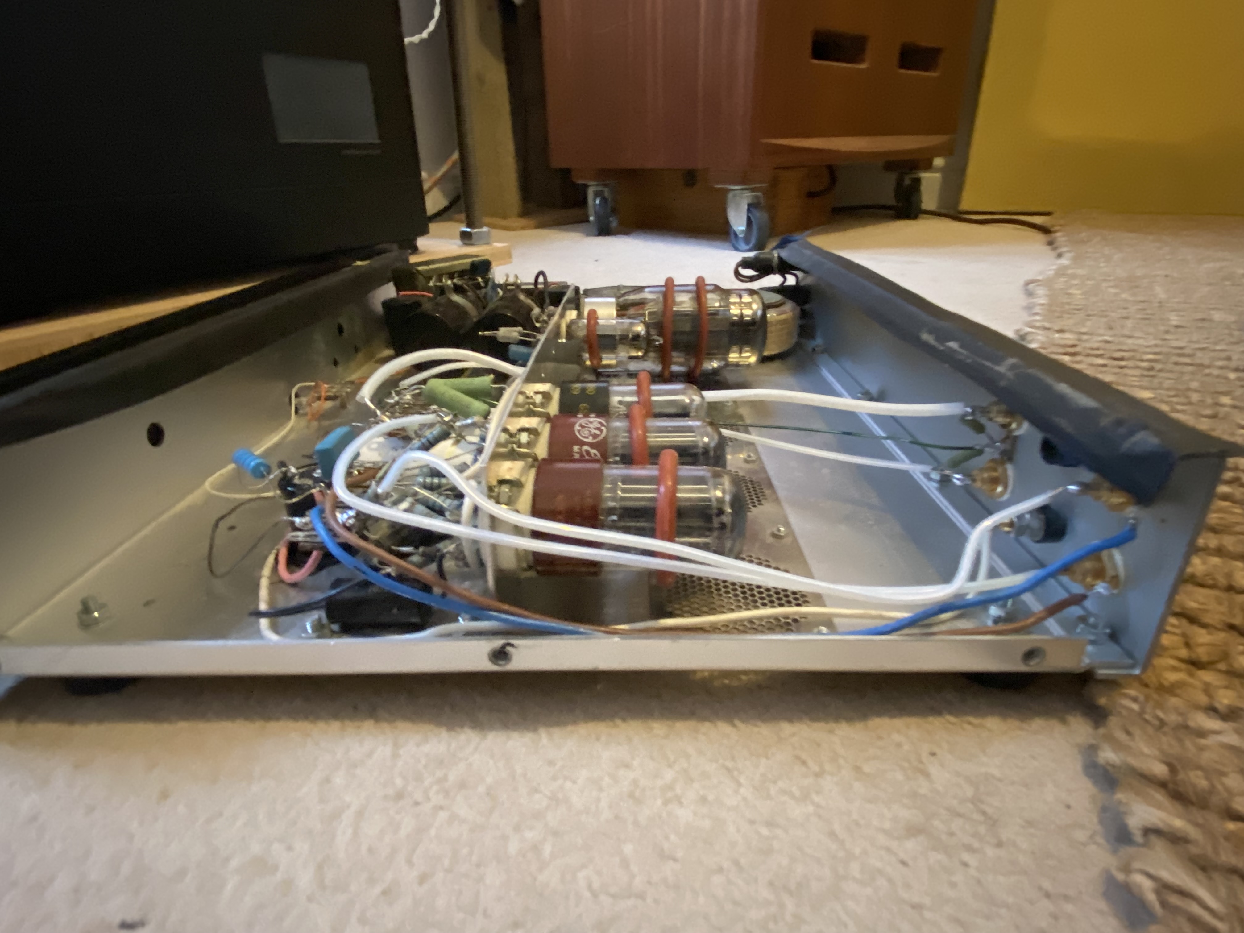

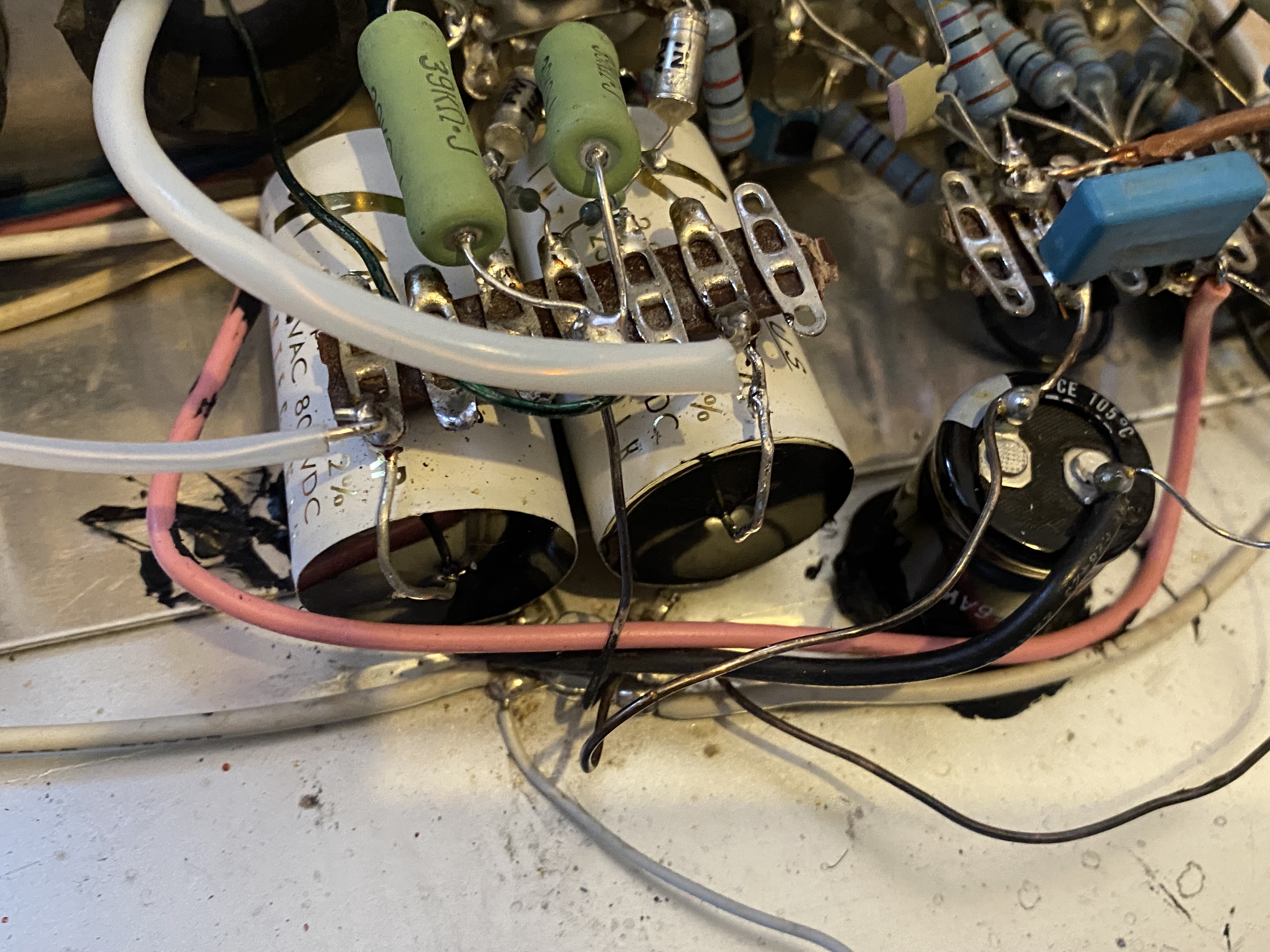

Hello Garrard lovers I've more tales to tell with regardsimproving the infrastructure of the Garrard 301. The Croft marque has many many fans all over the world and I'm one of them, I have a very modified Croft preamp and now a slightly (even more so now) phonostage. I have never been a big fan of the intrinsic Croft phonostages and have often preferred the extrinsic versions that Glenn used to make. My own Croft phonostage originally used to run three 6SL7 valves, I prefer the 6391 variant and this was decided upon after doing a massive 14 valve shoot-out back when you could buy valves very cheap and very cheerful from the US of A. Said phonostage decided to become sick with a dicky on/off switch, so I decided to use this an an excuse to get the thing check over and a subtle modification. Several weeks later and my Croft now had a part 6SN7 conversion, a subtle tweek which gives the thing more drive. Here we can see a few tasty caps which have been installed.

Here we can see the modification working with my old pair of 6391's and a rather nice Raytheon 6SN7 valve.
https://i.ibb.co/wh9MgsJy/IMG-2214.jpg
