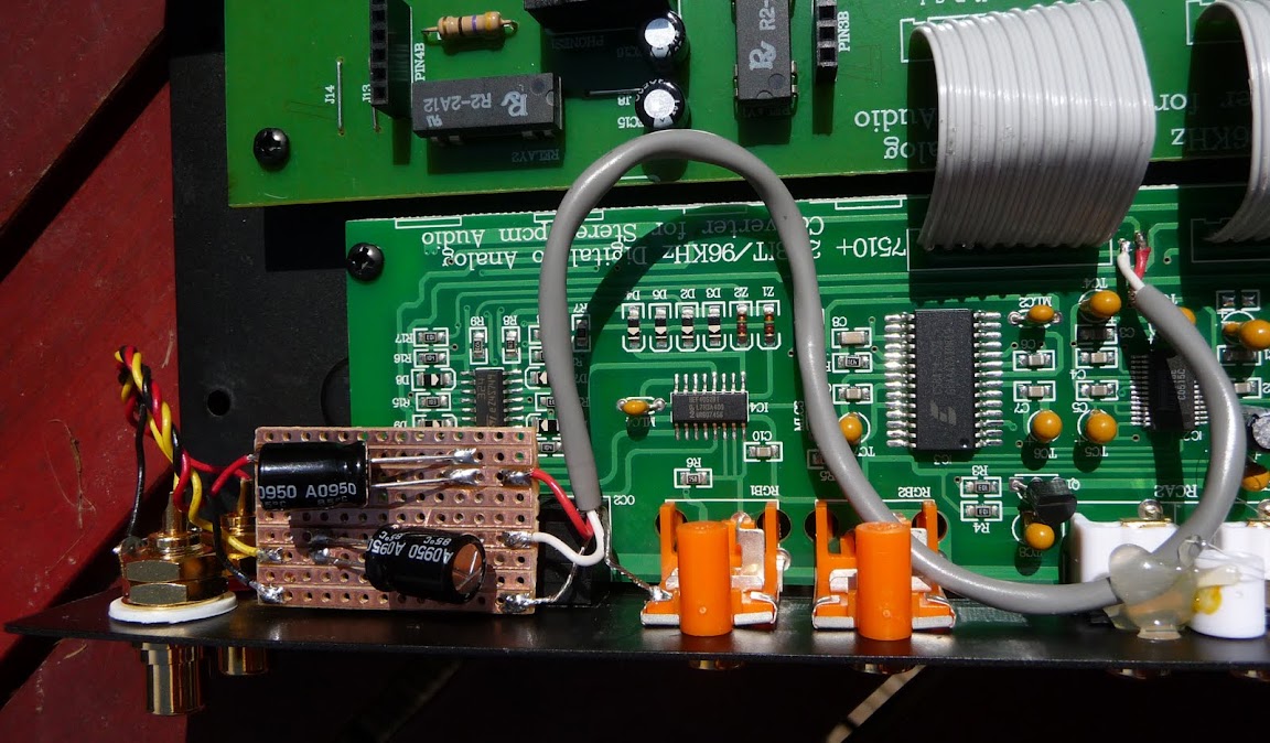

My thoughts are along these lines - if I remove the left hand op-amp and add the wire links, then if I place the caps somewhere in circuit between the DIL socket for the op-amp and the pins on the board connector then I should get the benefits of the passive mod with the muting circuit still functional.

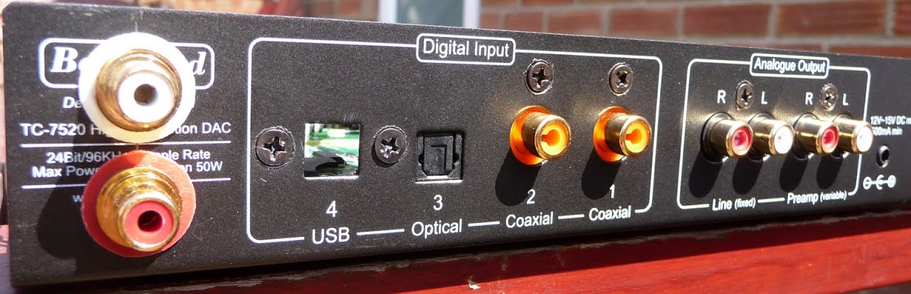

Below is my modded 7520...
http://lh4.ggpht.com/_nF_NkmjRbXg/TF...s1280/rear.jpg
http://lh3.ggpht.com/_nF_NkmjRbXg/TF.../s1152/Int.jpg
