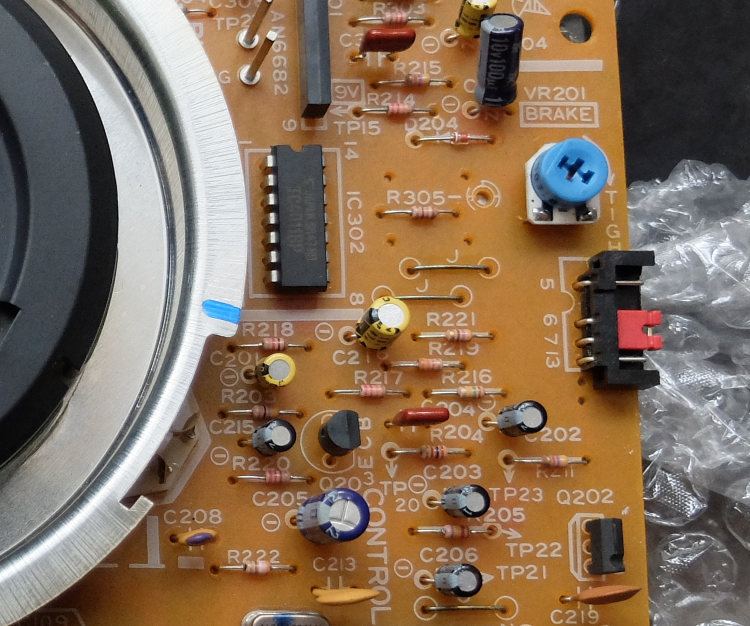

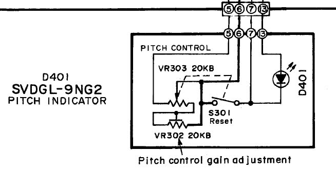

Nothing complicated, you just need to put a jumper across pins 6 & 7 on the main board, where the pitch fader is connected.
Connecting pins 6 and 7 gives the same result as placing the pitch fader control in the central detente position. So the fader will be completely out of circuit as it were. The deck will still have the fader fitted, so visually it will look the same, apart from the green LED not operating.
