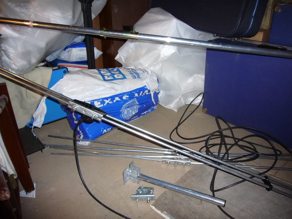

    The partially assembled FM aerial

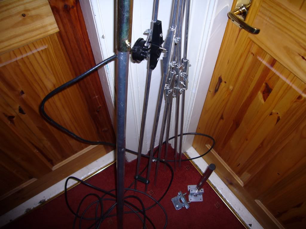

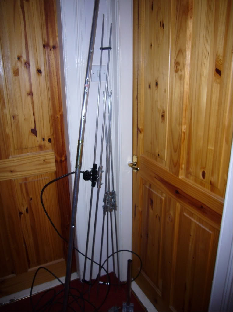

    Steve (Aquapiranha) came to my rescue with an unwanted Yagi based Antiference aerial a 5 element design with good pick up ability and well up to feeding a vintage Leak quality signals to reproduce. As you will also have read Steve (Aquapiranha) came to visit recently (see Link 3) and just before he came over he posted the aerial which arrived on the day he called in for a listening session.

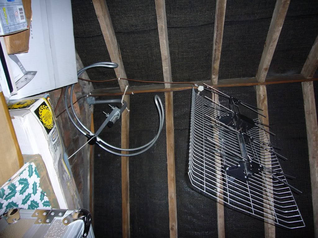

    With the weather being slightly cooler today I decided to fit it in my cramped loft (installing any aerial in a roof-space is not ideal as you will loose some of the aerial's signal strength). Having no real choice about this into the loft it went.
    The existing Omni FM aerial and Anti-ghosting TV aerial in the roof-space.
    This aerial is big with a very long, over 2m length and elements that are about 1m long, and there are 5 of those. I had an idea whee I wanted to put this aerial but after having a quick look in the crowded roof-space I had to abandon the first location and put it near the TV and original FM aerial.
    Now where am I going to put this ?

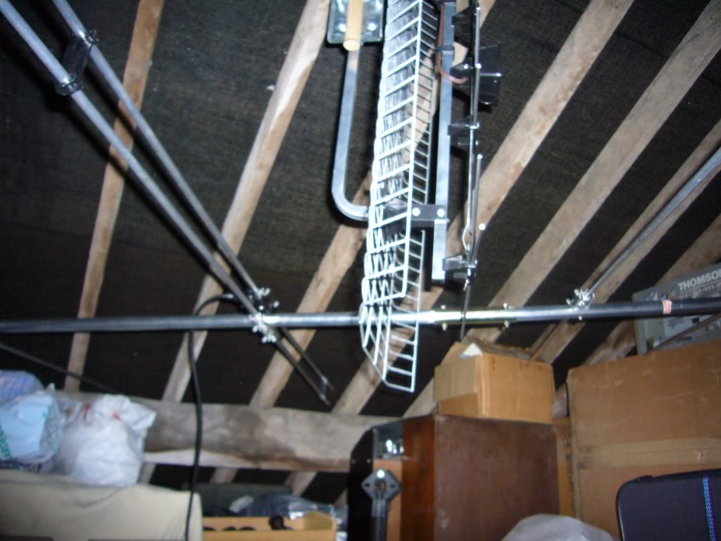

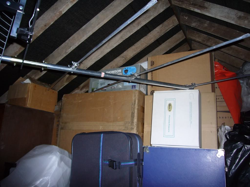

    After a lot of difficult and having to move some empty Hi-Fi boxes (a large percentage of the roof-space is full of such boxes ) and settled on a position and built it. While not ideal the aerial rests on some boxes and starts just behind the Anti-ghosting TV aerial and the original Omni unit (thankfully this close proximity has not caused any problems among the aerials )
    Its big !
    Fitting the co-ax cable was easy...however I had to use a connecting cable and good quality coupler, as the original co-ax used was just enough to reach the old aerial's mounting position. After making the connection I went downstairs to see what the signal strength was like on the Leak tuner....excellent slightly more than had been the case with the combination of the old Omni and the FM amplifier.
    It was however obvious that the fit of the Belling-Lee connector was not as tight on the old co-ax cable so I decided to solder the plug on. Very fiddly in the roof-space and it took a few attempts to get a really solid solder joint. I checked on the Leak tuner and I gained a little bit more signal...so it was worth the hassle and sweat (Dalek's do sweat by the way).
